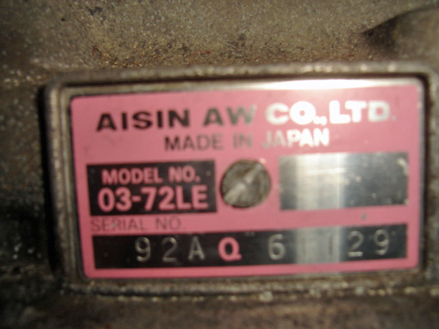

the 4speed, has a P/N button, for fast or slow shifting points, (delayed shift) on the console. BINGO FOR SURE 4SPEED !
the tracker has RPO tag in the inside glove box too. tell ing what trans is there. m41 RPO code (as built)
and the tag on trans, ends all arguments in 1second.
http://www.fixkick.com/tranny/automatic-...d-tag1.jpg
http://www.fixkick.com/specs/RPO/RPO.html
this it? this 4sped, the P/N button , proves its electronically shifted...
http://www.fixkick.com/tranny/slush/4sp-selections.jpg
really swaps happen so the trans looks like this its a 4speed.
the long bell gives it away. no governer inside, no vacuum modulator on rear , no vacuum line to it, 4speed.
http://www.fixkick.com/tranny/slush/slid...ump4wd.jpg

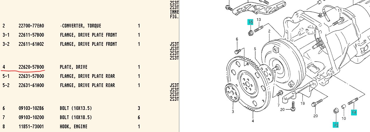

22620-57b00
suzuki stocks it ! (they want next unborn child) seems.
https://www.suzukicarparts.com/parts/199...eid=214820
[Image: 3_19_09_17_7_19_23.jpeg]
drive line parts not easy to find but the below car-parts.com show them..... ever use this great service N.america?
only fits this engine. G16
only trackers, sidekicks , vitara's and the X90 rare car.
will not fit the esteem with G16, at all.
will not fit the 3speed. either.
finding one is not easy. cept dealer.
wrecking yards may be lothe to remove one from good engine., call? go here?
its listed under Chevy/tracker, flywheel then when search ends, bingo flexplate words.
http://www.car-part.com/cgi-bin/search.cgi
also the VIN is useless for transmission ,only the RPO tag shows this.trans

is it too much trouble to tell me the RPO codes. on the glove box. (inside of door glove)? as-built it is.... those codes. all.
GM RPO 3Speed codes are MX1 and MX65
WHAT M code is there?
the crank bolt pattern is the same crank both engines and all trans, but not offset to clutch nor clutch pattern same.
i cant see your transmission there, id have to look at it with eyes or a photo to know.
off my page
M41 = 4 speed 03-72LE (electronic) A40 series, and close match is A44DE.
M65 = 3sp Auto 3L30 (with electric TCC lockup clutch but is not an electronically shifted tranny) and MX1
MM5 = Manual 5sp Type 1?
M59 = 5 sp manual too. Type 2?
is your car 2 doors, ? not even that disclosed (trackers with 2doors usualy have 3sp, but not true in canada, they had more choices sold there)
at a dealer, they would look up vin and use the serial at the end and see what the car had day1... in there GM data base.
I cant do that, nor can suzuki.
just GM. (GM today says, GEO WHAT?)
so it gets down to 2 facts RPO, or looking with eyes. at box.
sorry.....
it is a coin toss sure.
