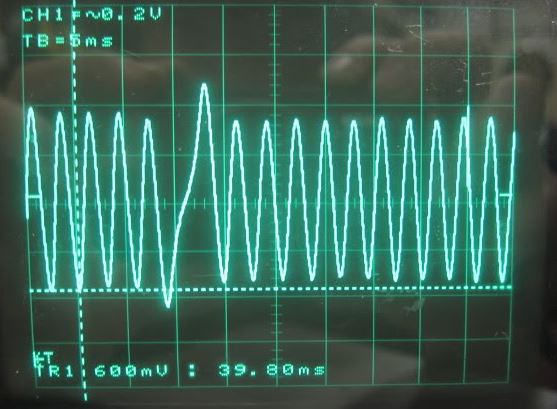

this is our USA Beta engine 1996 CKP tone ring, not saying yours is same, i cant do that. we dont have books from your country, here.
CKP ring. note the MISSING tooth?
[Image: 3_04_10_15_1_34_50.jpeg]

here is your tone wheel (well it ours, 1996 beta1 engine ) not saying yours is same , i can't do that. lacking your FSM book.
ours is 58/2 6degree tone wheel.
usa ECU , so yours can be different. but if not , now you know what the scope view will be. 58/2 pulses
[Image: 3_04_10_15_4_14_42.jpeg]

2 wire CKP sensors only, (is yours 2 wire?)
https://www.youtube.com/watch?v=2tHkV3v6XIo
see the first seconds here, of the VR CKP? first 3 seconds of video, repeat this... over and over. see?
see how weak it is. then it starts, and voltage just to +2 volts and -2v swings... (faster you go the more volts it does)
so.... that is how we check CKP
there is NO other ways.
sorry. and is 1st check. when spark is lost.
here is same deal, but note its only 0.2v up and down. weak as a cat.
see? great example of weak CKP, yours is new, and im sure strong. but is the timing right, does it match the cam? !
