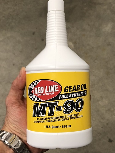

Lucky me...
Found this GL4 synthetic at our local auto parts store, Lordco, in British Columbia. Redline Product#50304 75W-90 $20
Also came in another weight too 75W-80 Product#50204
[Image: 2192_15_10_18_9_42_28.jpeg]
#34
nice find, you are so lucky to find it.
many stores have none.
and is needed too in the transfer case.
in use NAPA has it and if out of stock can get it in hours from other napa stores, call a head and they can get it for you.
https://www.napaonline.com/en/p/SLRSL24229
