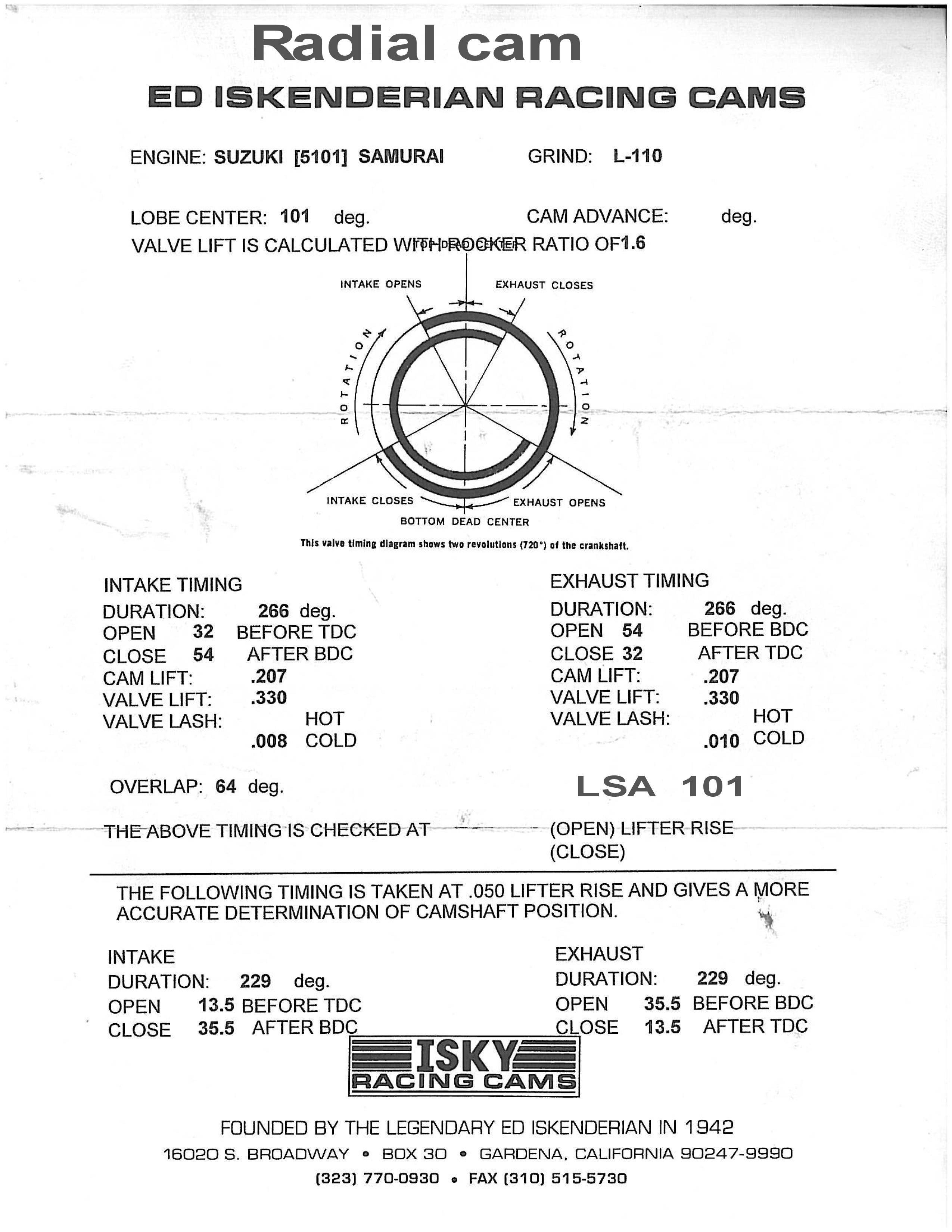

Finding CAM TDC - Zackman - 02-15-2016 Dear Fixkick: I am purposely starting this new thread, because the last thread had become so extensive, and for the benefit of others, I like to keep this issue (i.e., finding CAM TDC), separate from all what was covered about vacuum, etc. I do not know how to thank you for the time you take to answer me (and everyone!); all I can say is that it is MUCH MUCH MUCH appreciated. I totally agree with you that I have issue with cam timing. I am going to check that next week-end, since I have to fly out of town tomorrow. Please confirm my understanding about establishing CAM TDC. From reading everything you wrote in my last thread, I believe the simplest way to establish CAM TDC is by looking at the cam sprocket (wheel) mark as shown in your picture above, being at 12 O'clock, while the 4th cylinder piston is at its upper most position; is that correct? With respect to this topic, in one of your instruction pages you mention the following sentence, for which I need a little clarification. You state: If unsure that the dizzy is timed correctly? , you must pull the valve cover and find #4 at TDC and all valves with loose lash and cam lobes on the heals. (this is the only true path to success) turn the crank until ,this is attained. By "all valves with loose lash and cam lobes on the heals."; do you mean all valves, except valve 4, or including valve 4. Please clarify. Thanks agin, Zackman. RE: Finding CAM TDC - fixkick - 02-15-2016 your very welcome, mr, Zackman! that is best. cam timing, that is why I have a step in my procedure (step 42), to check compression, if that fails stop and correct errors. there are many ways to get errors. (when done) lash set wrong,? cam timed wrong,? bad valves.? if you time it correctly and say just one cylinder is at 100psi, no need to put engine back together and drive. see? head needs to be pulled. (or lash corrected) if all 4 cylinders read 100 , then the cam was timed wrong(sea-level , you are at 25 meters altitude, yes, sealevel) yes, that needs to be edited, but i cant now,, i don't have admin on those pages, now. let me explain there are many ways to find TDC firing. i have a page just for that. http://www.fixkick.com/t-belt/TDC/TDC.html but in this case, there is no reason to do that, or some odd ways, Like blowing air in cylinder spark plug holes, with lips. the valve cover is off, and the cam and valves are fully exposed. there is also no need to do that, at all. The HEEL, is the back side of the lobes.. and is the firing side of cam lobes, thusly #4 is firing, when the 2 cam lobes on #4 (only) are at the rocker lifter contact points. (on a running engine (fully serviced), 2 valves lash is loose (per cylinder) means, its FIRING.) but but but none of that matters, (its only commentary, and observation, to the belt installer, ) lets say the belt was installed wrong and the #4 rocker pair (you just looked there now) and were, on the lobes, lifting valves. you'd know in 1 second you timed the cam , dead wrong, see? and what might be wrong, that is easy, to say, you used the wrong KEY , the (I)key. "I" is WRONG. (or use "I" marks, , all "I" marks are wrong) if you used the "E"key and the 60a spoke, "E" outer edge mark (machine cut mark) (do you have this, cam cog type? with I/E keys? you never said, if you use that correctly , there is no need to even look at the #4 valves or lobes. ever. you can for confidence building sure. and validation. sure wish I knew what cam cog wheel you have the 60a or the one with only 1 titty mark like the 1990 had. (the exact day suzuki changed in 1990 , ive no idea) Facts:; the cam is in fact timed at #4 firing at TDC, and with rockers on #4 on heels of the cam, this is a fact. "all valves, #4 with loose...." it should read, But on 8v you had them all set loose, (this comment is for 16v) I used to have the 2 engines, on one page and then slit them in to 8v and 16v pages, so this comment is wrong, well needs to say look at lobes" the timing is simple , there is no variances. if the cam mark 60a, is at 12m aligned with top back pan mark this is #4 firing, the CAM design is fixed that way, no way to change that. then the crank is at 12pm, TDC firing, 0degrees, 12pm, at the top edge of the crank cog, is TDC 0, and the pump has TDC 0 ARROW both at 12pm. the #4 and #1 pistons share this same TDC mark. ONLY the cam dictates which cylinder fires. all that matters (timing wise ) is these 2 photos. this shows, crank at TDC and cam at #4. ![]() this shows the false marks, clearly , as you can see the CAM key IS down at 6pm, clearly. it also shows where 60a spoke goes. (up) ![]() see my 4 white painted marks. the 4th mark unseen is the pump 12pm ARROW. best is just time it , ignoring the #4 cylinder, comments, the FSM from Geo makes no mention of #4 at all. ignore, #4 totally. set it correctly using the correct marks! then set lash. to spec. (rolling the crank per FSM pages) then check compression, 150 PSI min. at your altitude. (is your gauge in BAR or kPa"?) 10.34 bar. minimum! at wide open throttle it's good, now time the distributor, with the freeze jumper planted. keep in mind if the distributor was removed, for any reason, timing it will take patience. and futile if cam is timed wrong. and know that it can be timed, with a none running engine. using a strobe light. (timing light) just cranking with fuel pump relay pulled.(green socket) sure can, and you can turn the distributor, and get #1 to hit near 0 TDC, , then put back the fuel pump relay and engine now starts. then plant the timing freeze jumper (hot) and set timing to 8deg. BTDC per the hash marks on the TDC scale. on front cover. 2,4,6,8 marks. per my page (i added comments) http://www.fixkick.com/IGN_timing/8v-procedure.html#drawing2 2 degrees per tick. it is. facts more?? if you set the static timing wrong then scan tool report this lies + added advance = reported timing the vacuum line on the EGR is dead at idle on all G16;s made. to the vsv or out of it, zero vacuum at idle. this is double true. 1: ecu has valve closed. 2: TB , ported vacuum blocked. RE: Finding CAM TDC - fixkick - 02-16-2016 The distrib (the Dizzy) can be timed , using my find TDC page. this page shows all known ways of finding #1 firing, (i hoped) 12 ways from Sunday. http://www.fixkick.com/t-belt/TDC/TDC.html RE: Finding CAM TDC - Zackman - 02-16-2016 Thank you very much, as per usual. I appreciate you take time to provide such thorough answers. Unfortunately, I have to leave home for the rest of this week. I will get to the car hopefully next week-end, and report back. Again, I cannot possibly express my sincere appreciation, the way you deserve it. Regards, Zackman RE: Finding CAM TDC - fixkick - 02-16-2016 no hurry ever, have a good trip. you are very welcome and we can find all bugs, in car ,1 by 1, glad to help you. RE: Finding CAM TDC - Zackman - 02-16-2016 Just a quick question: Firing cycle is equivalent to compression cycle, correct? In other word, the distribute is set at 11 O'clock when cylinder No. 1 at its TDC at compression cycle; is that correct? Regards, Zackman RE: Finding CAM TDC - Zackman - 02-20-2016 Dear Fixkick I was wondering whether you could clarify the following question for me? Is Firing cycle equivalent to compression cycle? In other word, the distribute is set at 11 O'clock when cylinder No. 1 at its TDC at compression cycle; is that correct? Regards, Zackman RE: Finding CAM TDC - fixkick - 02-20-2016 the compression stock, (goes up) compresses the 400cc of air/fuel in to a 55cc combustion chamber (all valves are closed,) and at about 8 degrees (before) TDC the spark fires. on #1 the rotor most point to #1 spark wire, and bam, #1 cyl. fire and starts the power stroke (going down) firing happens at end of compression cycle, 8 degrees before the end of it. in fact. the distrib can be timed on any of the 4 top cap terminals. but the harness will not reach on all 4. so.. it's timed at the 11 o-clock term. this is the factory setup. and referred to over and over in the FSM, to do other things related, so that is why we use 11-oClock the CMP has no idea at all were #1 is, it only knows how to fire 4 times per turn. the Otto Cycle engine: intake stroke (sucks, while piston going down) sucks in 400cc of air. compression stroke , piston rises from BDC to TDC) firing instant, is now, 8degreses BTDC. (combustion or power cycle starts NOW) air fuel burns fast. and piston is at power stroke TDC to BDC. now at BTC , piston goes up and exhaust cycle happens. the distributor is installed so that the rotor points to 11 oclock cap terminal. #1 firing with crank at TDC 0degr. mark (there is only 1 mark) or attempt 8degrees before TDC., id not try. and both #1 cylinder intake valve are closed. (called lash loose #1) then the clamp bolt is set,(tight) on distrib, base the #1 wire inserted to 11oclock to #1 plug then CW 3 to 3 plug. then CW 4, etc. last CW 2. per drawing on timing page 8v start engine, use timing light to hit 8 degr, BTDC, with light. timing freeze jumper in place. RE: Finding CAM TDC - Zackman - 02-22-2016 Dear Fixkick: As per usual, thank you for the great explanation your provided above). Today, I took the timing belt cover off to check whether the Crank TDC was set right, and that also the Cylinder 1’s TDC (at the firing cycle) was also set properly, so my distributor’s installation would be correct. Well, they were are set correctly. However, again, I have another fundamental question. There is a video on the Youtube that very beautifully, with a great detail, explains and demonstrate valve adjustment of 1.3L 8V Suzuki Samurai (1985-1995) engine, which seems to be almost identical to 1.6 8V engine that I have. In that video, when the technician wants to adjust the valves, he states that adjustment should be done when the lobe of each cam is at 6 O’clock , so that rocker arm is at the heal the cam of the valve being adjusted (that is the heal would be at 12 O’clock). This makes complete sense to me. (Please see the video at: https://www.youtube.com/watch?v=ZPVn2xwO81Q - check at time 1:14) However, I have now two engines; one being the new (used) one that I have recently installed in the car, and my old engine (which used to work perfectly before one of the connecting rods snapped!). When I put the engine at the TDC of Cylinder 4 (that is when the notch on the cam wheel is at 12 O’clock, as shown in the picture you posted in my thread), then the lobe of the intake cam of the cylinder is not exactly at 6 PM. If I put the lobe of the cam that corresponds to the intake valve of cylinder 4 at exactly 6 PM (which I suppose should put the lobe of the intake of cylinder 1 at 12 O’clock), then the factory notch on the cam wheel moves to 2 O’clock position, instead of the 12 O’clock. Exactly the same thing also happens when I check the old engine. Can you please explain to me what is going on? The two engines cannot be coincidentally set incorrectly at exactly the same positions! I would appreciate your comment in regard to the above issue. Now, if the setup is correct, I am going to conclude that the only reason I cannot get rid of the backfiring and low power is the car’s computer, since the distributer is also set properly, and that the timing is set at exactly 8 deg. BTC, with a strobe light (and the static timing jumper). Looking forward to hearing your comments. Regards, Zackman RE: Finding CAM TDC - fixkick - 02-22-2016 (02-22-2016, 10:55 AM)Zackman Wrote: Dear Fixkick: this is G13 cam, L-110 the intake closes late. 54deg after BTC ! (valve over lap this is called, and is for max power at say 4000 rpm, and weak compression cranking, (say) and opens 32deg before TDC, ( this means it opens early before the exuast stroke is finished, (same reason.0 http://www.fixkick.com/isky%20cam%20card.jpg all that matters, here, is lash done (ANYWHERE) a the HEELS both crank and cam code keys are not damaged. the cam not keyed at "I" slot (no photos yet so?) and not timed using the "I" markers on outer rim. and engine makes 150PSI. as you can see the cam is time unlike any compressor..... a compressor will make max compression, no engine does. now sammi PDF, G13 http://www.fixkick.com/sammi-stuff/books/sammi-v1.pdf page 3-54. step 4. (lash) see them check using only 2 steps, just like the G16 1257 3468 and forgets to say Clockwise turn it, oops. this is the SUZUKI way and works ever time. makes the job 2 times more easy. none of the cam lobes are centered on TDC, not one. (like compressor) how ever if engine was VVT engine,its closer to TDC. but lash is loose and valves are closed, At TDC and makes 150psi min, compression cold , under starter power. W.O.T that matters. that 150 on mine does, 170psi warm, easy. even with 190k miles on it. back firing can be bad timing (top reason) cam or spark. or burned valves. not doing compression tests is a travesty. on a new engine we do it on the pallet. why put a dead engine in a car.? huge labor, all just a huge waste of time. the compression tests, tell you, that the valves are not burned up, and the rings, not collapsed and more.. its a bench mark, the engine will do like near 300 PSI with a compressor cam in it (theory and fact) with engine cam in it , it does 150 to 170 , cold to hot. (the cylinders get more round hot) the CR dictates the compression, never displacement and the cam profile and altitude. the car has a stock cam so you will get 150psi, min, at sea level to 1000 feet. this test is a very good test. as is the leak down test. for finding where the leak is. I cant hear or see it backfire, so cant speculate too well! are the HV wires timed right, if it runs ok at one rpm , the wires are right. does it have china rotor in it, that times 3 ways, (bs), then buy a bosch rotor , they dont. misfiring is complex and best to know when it happens and not. under all conditions. and what it sounds like. is it backfiring, to air cleaner, or to exhaust muffler. is it worse cold or hot engine? can you get full wot power from engine? |
