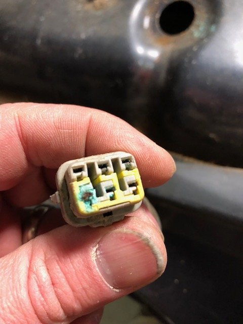

pump connector on a Toyota PU. what do you think this does hot/cold/wet/dry ? answer anything it wants, IT'S BAD.
[Image: 3_28_05_18_6_56_33.jpeg]
