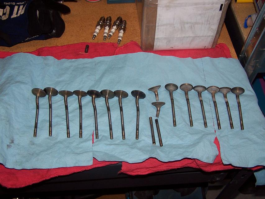

The worst case:
In the military we called this "messing (stronger words) up a soup sandwich."  He buddy , your mech could "Frak up a soup sandwitch"
Say ?
You? let the TIMING belt slip (60,000 service , was/ is not a thing for you?)
Then you or Mr. Soup,  try to set lash and get confused about 4 cycles, and TDC and all that bother.  ?
Then manage (horror) to get the valves lash so wrong, as to have 1 valve, say , #1 exhaust last so wrong,  and was set ,so it never closes, in a gross manor?
The #1 piston, when hot this day,  and at high speed , hits the valve and bends it.  Kiss off #1.  Here is Mr, Soup doing a bundle.
I think both engines, are free-running, dispite SUZUKI, quoted warnings below, but if you work hard, at that soup sandwich, bad can happen. (Takes hard work)
T-belt  slipped, valves noisy or smacking  your piston tops
