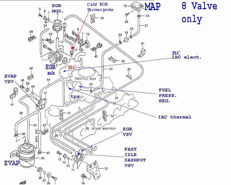

The 8valve engine, parts.
Image 53 of 54
![](../images/vacuum1.jpg)
the cars underhood sticker shows vacuum but that sticker nor mine below shows the 3sp A/T vacuum to the 3speed vacuum modulator. that fitting is located on the rear of the intake manifold. seen here in this slide show.
