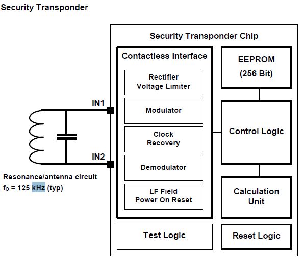

The transponder cell, seen here below, uses no  BATTERY AT ALL, "no wires"  is uses the ENERGY of the 125khz RF signal (or higher) as the chips power source. (just like toll road tags do, only the frequency and power levels are huge there) AKA RFID. to some.

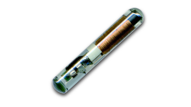

Seen here; (a good example to see how she  works is the glass type). My WK jeep chip is black plastic, no fun looking at it.? Mine uses the Philips ID 46 chip PCF7936 Crypto 2 transponder chip.
This glass ampule, has what ? , oil inside or a  liquid that does not expand at say -40F,  a coil antenna, and the electronics chip inside it.
The  cars key slot antenna feeds a (radio freqency) & RF receiver there, and a diode bridge rectifier module, that creates the power source inside the ampule, in 39mS max.  (fast) It wakes up now and the chip here, talks to the ignition WIN module reciever.
The rolling encrpyted passwords transmitted, are not crackable by any one.  Bingo car starts. IMMOibiler is happy. IMMO lamp goes out. Engine can now run longer that 3 seconds...  My local locksmith programmed 3 extra keys for me, for $75 (labor)
