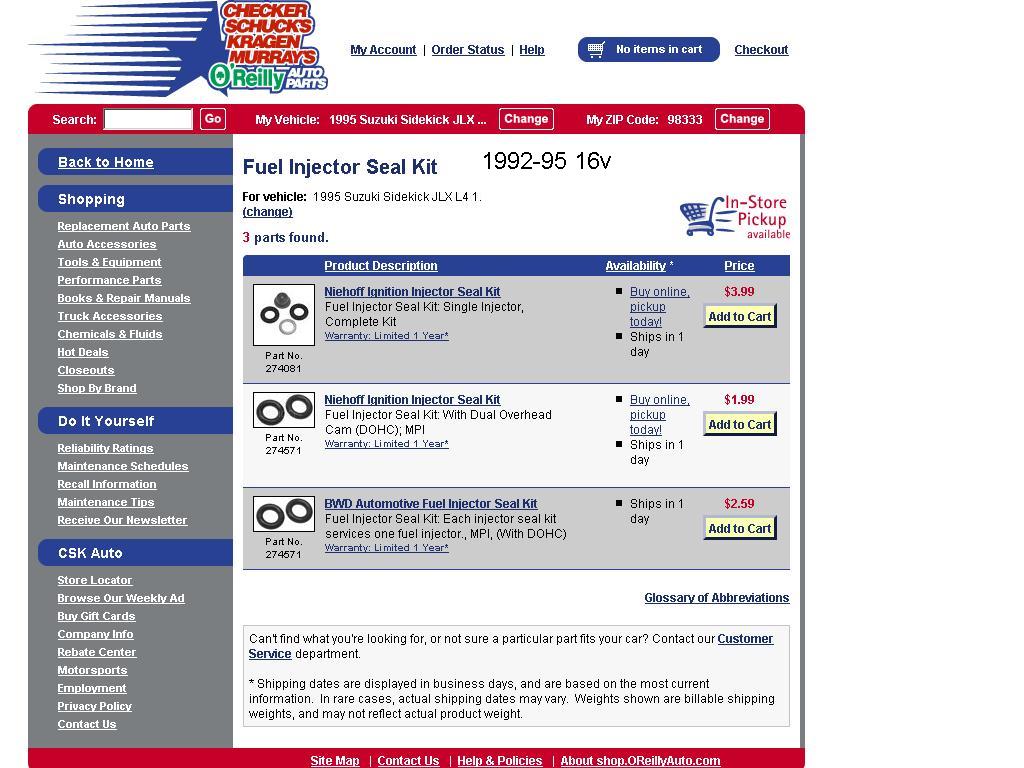

What some parts houses sell: . They are very inexpensive compared to Suzuki.
The parts must  be fuel proof and 200ºF+ thermal proof.  (actually  more,  if the engine overheats do you want the seals leaking then,  NO)  Engineering 101.?

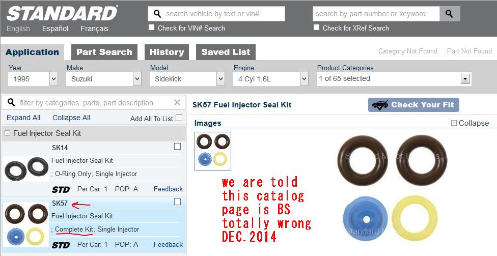

The SMP brand "Standard" has errors in their catalog (2014) showing SK57 as  fit, this is wrong.  Looking at all G16Bs (GM and Suzuki) the catalog has errors. (I did file the complaint)
The correct seal is SK53, (we think)
SMP fails to list MPI seal kits until 1994, oops and they have them oops 2 !
and gets it wrong. and no J18 sport seals.

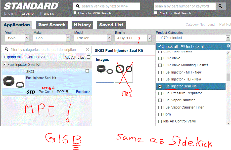

and for GM ,(Geo)
They show SK53 fits, and is same exact engine,  then fails to show its MPI injector , even though they sell MPI and TBI injector, one line up.
So I think if you order, SK53 for all Trackers and all Sidekicks MPI 1992 to 1998 it's a win..  or buy BECK.
In 1999 it changes to SK18 (theory)
When SMP wakes up and learn there are 2 engines, this will end.  G16a or b (TBI / MPI respective)

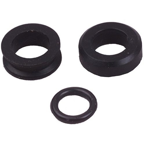

Beck claims this.

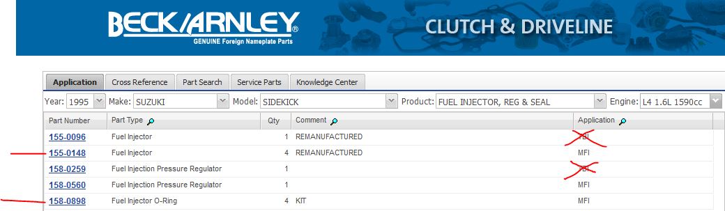

Beck 158-0898
Now find who sells them !
First find the right seal kit, then Google for local supply.  Like Beck 158-0898
